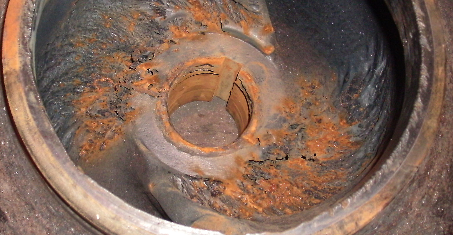

Everybody likes a quiet pump — one that just does its job and doesn’t break down often. But a noisy pump raises concern. Although the noise is often attributed to cavitation, not every noisy pump is suffering from this problem. Failing bearings, flow turbulence, recirculation, and even a machine’s mechanical or electrical geometry can also generate noise — any of which may be a more immediate problem than long-term damage from cavitation.
Cavitation erodes the suction eye of the impeller without affecting its other surfaces (Photo 1). Disassembly and inspection will confirm if significant cavitation is responsible for pump noise. But before you tear that pump open, you should first rule out other potential causes with some non-intrusive tests. Here are four procedures you can follow when trying to track down the source of the noise.

Next, increase the suction pressure (head) if possible, and listen for a decrease in the noise. If suction head can’t be increased, reduce it, and listen for an increase in noise. Cavitation is directly related to suction head and flow, so changing either of these should cause cavitation noise to change accordingly.
