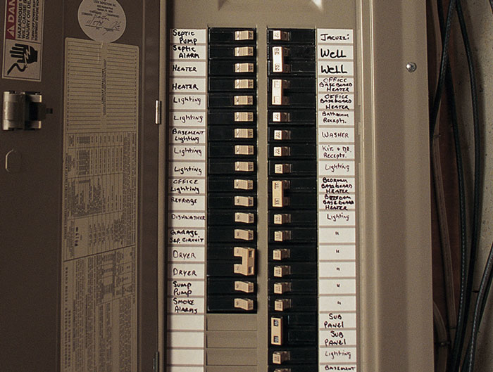

As noted in NFPA 70B, insulated-case and molded-case circuit breakers should be kept clean of external contamination (Comstock/Stockbyte/Thinkstock).
