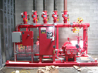

Fire pump controllers are control panels containing electrical components, such as circuit breaker, switches, relays, and other devices, dedicated to the operation of fire pumps. The devices within a fire pump controller panel perform such functions as: receiving signals from alarm devices, such as pressure operated switches, sprinkler alarm valves, or remote fire alarm equipment; activating motor control devices to provide electric power to motors driving fire pumps; and monitoring fire pump operation and performance.
All controllers are completely assembled, wired, and tested by the manufacturer before shipment from the factory. Some controllers need to be shipped in sections for various reasons, such as shipping limitations due to size. Controllers shipped in sections are completely assembled, wired, and tested by the manufacturer before shipment from the factory. Such controllers are reassembled in the field; their proper assembly is verified by the manufacturer or designated representative. Fire pump controllers suitable for use as service equipment are marked accordingly.
