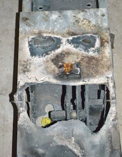

Photo 3. This 800A vertical busway section was installed in a multi-story apartment building. A distressed “face” was melted into the enclosure after it was involved in a major arcing ground fault event.
With busway, you can see there are many accessible points-of-entry into the raceway for liquid contaminants to penetrate and contact uninsulated, energized conductors. This is why it is important to prevent liquid spills near or onto busway. Liquid spills are especially disastrous when the liquid runs down a vertically installed busway in a multi-story building application (Photo 3). Because of these vulnerabilities, busway has maintenance requirements specified by the manufacturer and organizations such as the National Electrical Manufacturers Association (NEMA).
Arcing ground faults on busway, related to not following the manufacturer’s and NEMA’s maintenance recommendations, have resulted in huge property and electrical equipment losses. In addition, catastrophic business losses typically occur due to fire and sprinkler-water damage.

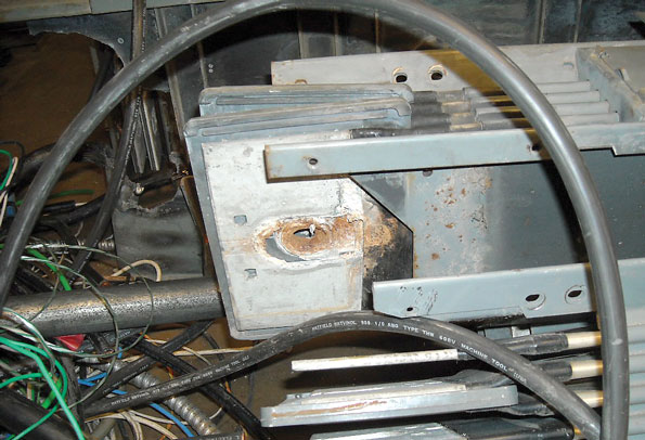

Photo 4. Leaking water with road-salt contamination in a parking garage floor entered this busway joint. The subsequent fault melted a fist-sized hole completely through the busway.
Reasons for concern
A recent analysis by Hartford Steam Boiler Inspection and Insurance Company indicates that there have been many failures of vertically run busway installations in multi-story buildings. Other horizontally run busways have also failed when subjected to long-term water or other contamination sources (Photo 4).
