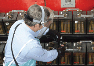

Secondary batteries play an essential role, usually as a source of standby power, in many areas of business and commerce, such as telecom and data centers. To ensure those batteries deliver their full performance when called upon to do so, you must rely on a regular testing regime. But the big question is: What type of testing should that be?
Let’s start by making it clear that no one testing method tells the entire story — each has its own set of benefits and tells us something about the battery string. This is why a regular broad-based maintenance schedule is required to ensure standby batteries (when required) operate as expected.
Typical methods of battery testing include:
  • Visual inspection — A visual inspection locates cracks, leaks, and corrosion. You can find these problems before they become catastrophic failures; however, visual inspection says nothing about the string’s state of charge (SOC), capacity, or state of health (SOH).

  • Impedance testing — An impedance test does not measure the capacity of the battery, but it is an indicator of the SOH of the battery.
  • Discharge testing — Discharge testing is the only form of test that will determine the actual capacity of the string, but not necessarily the SOH.
IEEE standards (see IEEE Standards At a Glance) recommend that discharge testing be performed at the time of a battery strings installation and then every two to five years after that, depending on the age and capacity of the string. Specially designed test sets are available to make this process as easy and convenient as possible. For complete discharge testing, the battery must be taken out of service for the duration of the test. This can easily last as long as two days in order to allow a full discharge/charge cycle to be completed. Although it offers the most accurate results possible, this test method is clearly costly, time consuming, and often inconvenient. How many users do you know that would be okay without standby power for two full days?
One way of addressing this problem is to carry out limited discharge testing, which involves discharging the batteries by up to 80% without taking them out of service. This yields results almost as accurate as those provided by carrying out a 100% discharge test.
Partial discharge testing is a very useful way of assessing battery condition, but it is not ideal in every application. For one thing, the test is still time consuming. Although the batteries remain in service — should they be called upon to supply power at the point of deepest discharge during the test — they will only have 20% of their full capacity available.
It is also recommended that impedance testing be performed quarterly. Although impedance testing does not directly provide information about battery capacity, it is the only method that reveals the SOH of the battery. Impedance testing can be performed without taking the battery out of service.
