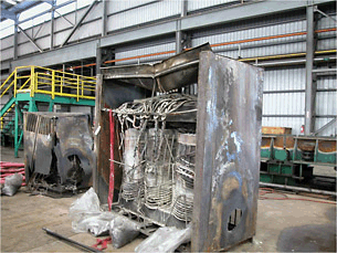

Case study 1 — A customer installed new switchgear, transformer, and reactor. A new self-contained substation was installed, which included a battery bank and charger. When installed, the contract did not require the installing company to test the molded-case circuit breakers in the panel that fed the battery charger. After all, those circuit breakers probably cost less than $100 each — it would cost more than that to test them. Plus, considering that the equipment was brand new, maintenance personnel did not check on it often.
One night, the underground feeder cable from this new switchgear failed. The 100A 2-pole circuit breaker feeding the battery charger was defective and tripped (this 100A circuit breaker would trip with only 45A within 70 sec), causing the battery bank to slowly discharge. The fault caused considerable damage to the switchgear, transformer, and reactor, because the circuit breaker protecting them had no control circuit power from the battery bank. Photo 1 shows the resulting damage while Photo 2 shows the offending battery charger. This incident cost upward of $5.2 million, all because a $100 circuit breaker was not tested during installation. This case study demonstrates why protective devices on critical loads should always be tested and verified, regardless of the perceived value of the protective device.
