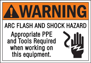

I’ve been told you are making a mountain out of a mole-hill — in that inexpensive generic warning labels can be applied to the electrical equipment to meet the requirement.
Counterargument: Generic labels, such as the one in the Figure on page 12, are non-compliant per 130.3(C) of NFPA 70E-2009, because they do not inform the in-house or contracted worker about the necessary level of PPE. Thus, in the event of worker injury due to an electrical accident at your facility, generic labels could be cited as cause for the accident.
