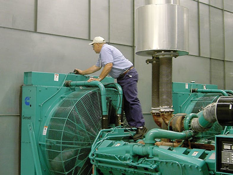

General inspection
When the generator set is running, operators need to be alert for mechanical problems that could create unsafe or hazardous conditions. Following are several areas that should be inspected frequently to maintain safe and reliable operation.
Exhaust system: With the generator set operating, inspect the entire exhaust system, including the exhaust manifold, muffler, and exhaust pipe. Check for leaks at all connections, welds, gaskets, and joints — and make sure that the exhaust pipes are not heating surrounding areas excessively. Repair any leaks immediately. Check for excessive smoke upon starting: It can indicate possible performance and air quality issues that may require immediate attention.
Fuel system: With the generator set operating, inspect the fuel supply lines, return lines, filters, and fittings for cracks or abrasions. Make sure the lines are not rubbing against anything that could cause an eventual failure. Repair any leaks or alter line routing to eliminate wear immediately.
DC electrical system: Check the terminals on the starting batteries to make sure the connections are clean and tight. Loose or corroded connections create resistance, which can hinder starting.
Engine: Monitor fluid levels, oil pressure, and coolant temperatures frequently. Most engine problems give an early warning. Look and listen for changes in engine performance, sound, or appearance that will indicate that service or repair is needed. Be alert for misfires, vibration, excessive exhaust smoke, decreases in power, or increases in oil or fuel consumption.
Control system: Inspect the control system regularly, and make sure it is logging data properly during engine exercise. Be sure to return the control system back to normal automatic standby (AUTO) when testing and maintenance are completed.

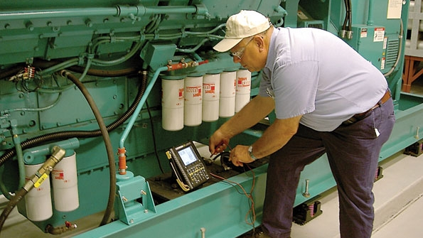

Starting batteries
Weak or undercharged starting batteries are a common cause of standby power system failures. Even when kept fully charged and maintained, lead-acid starting batteries are subject to deterioration over time and should be replaced approximately every 24 to 36 months — or when they no longer hold a proper charge. NiCad starting batteries require less maintenance than lead-acid and are often used in mission-critical applications. However, they are also subject to deterioration and need to be regularly tested under load. See the Table for the recommended inspection interval for lead-acid batteries and the charging system.
Testing batteries: Merely checking the output voltage of the batteries is not indicative of their ability to deliver adequate starting power. As batteries age, their internal resistance to current flow goes up, and the only accurate measure of terminal voltage must be done under load. On some generators, this diagnostic test is performed automatically each time the generator is started. On other generator sets, use a manual battery load tester to verify the condition of each starting battery.
Cleaning batteries: Keep the batteries clean by wiping them with a damp cloth whenever dirt appears excessive. If corrosion is present around the terminals, remove the battery cables and wash the terminals with a solution of baking soda and water (¼ lb baking soda to 1 quart of water). Be careful to prevent the solution from entering the battery cells, and flush the batteries with clean water when finished. After replacing the connections, coat the terminals with a light application of petroleum jelly.
Checking specific gravity: In open-cell lead-acid batteries, use a battery hydrometer to check the specific gravity of the electrolyte in each battery cell. A fully charged battery will have a specific gravity of 1.260. Charge the battery if the specific gravity reading is below 1.215.
Checking electrolyte level: In open-cell lead-acid batteries, check the level of the electrolyte at least every 200 hr of operation. If low, fill the battery cells to the bottom of the filler neck with distilled water.
