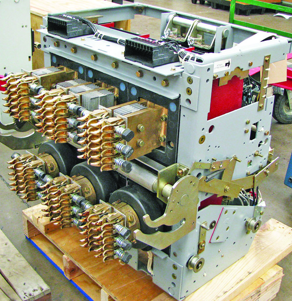

LVPCBs (Photo 1 at right) are also known as air-frame and draw-out circuit breakers. There are five major assemblies on a typical LVPCB:
    1. Disconnects or Stabs
      • Main disconnects — connect the circuit breaker to the main bus.
      • Secondary disconnects — connect the circuit breaker to the control circuits.
      • Ground disconnect — connects the circuit breaker to the ground bus.
    2. Contacts
      • Arcing — transfers the arc to the arc runners in the arc chute.
      • Main — carry the main load current.
      • Auxiliary — make and break the control circuits.
    3. Arc Extinguishers or Arc Chutes — interrupt and contain the arc.
    4. Operating Mechanism — opens and closes the contacts.
    5. Overcurrent Trip Device — modern circuit breakers have digital trip units, although older units could be air dashpot or oil dashpot types. Typical functions are long-time delay (LTD), short-time delay (STD), instantaneous (INST), and ground fault (GF).
Medium-voltage circuit breakers have the same basic components as their lower voltage counterparts, but use protective relays that are separately mounted in the switchgear. MVVCBs use a vacuum bottle instead of contact assemblies and arc chutes found on MVACBs. Photo 2 (right) shows a typical MVACB, while Photo 3 shows an MVVCB.
Main Disconnects (stabs)
The main disconnects connect the circuit breaker to the bus. LVPCBs typically use either vertical or horizontal rows of straight, spring-loaded fingers to make contact with the bus bar, although on larger frame sizes they may have round or “tulip-style” disconnects. Photo 4 shows the backboard assembly of an LVPCB with primary, secondary, and ground disconnects clearly visible.
Most medium-voltage metal-clad circuit breakers will use “tulip-style” disconnects (Photo 5) and have some type of spring around them to ensure good contact with the bus. Medium-voltage, draw-out circuit breakers have the primary disconnects in the switchgear guarded by a shutter mechanism installed in the switchgear cubicle. As the circuit breaker is removed (racked out), the shutter closes. When the circuit breaker is racked into the “connected” position, the shutter opens, allowing the primary disconnects to make.
