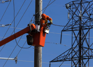

Remember the 10-ft circle of safety
Most electric utility companies have programs set up in their respective service areas that address overhead conductors. Each will take various approaches to provide a safe work environment for the contractor and general public. However, it's ultimately the responsibility of your company and your workers to ensure that you maintain a safe distance from overhead energized conductors — especially if non-qualified electrical workers are involved.
The guideline you must follow is often referred to as the “10-ft circle of safety” rule. A careful review of the Occupational Safety and Health Administration (OSHA) regulation clearly identifies the distance you must maintain while performing work near overhead power lines.
1910.333(c)(3)(i)(A) — When an unqualified person is working in an elevated position near overhead lines, the location shall be such that the person and the longest conductive object he or she may contact cannot come closer to any unguarded, energized overhead line than the following distances:
(1) — For voltages to ground, 50kV or below: 10 ft (305 cm);
(2) — For voltages to ground over 50kV: 10 ft (305 cm) plus 4 in. (10 cm) for every 10kV over 50kV.”

  • Keep all cranes, scaffolding, and high-reach equipment away from overhead power lines. Always keep yourself, your equipment, and anything you carry at least 10 ft away from overhead power lines.
  • Maintain a distance of 25 ft from overhead transmission power lines (up to 490kV). When performing construction activities, use of a spotter is recommended to ensure compliance with the proper line clearance. If clearance cannot be obtained, request the electric utility to de-energize the lines.
  • Never place ladders near power lines. When working on or near ladders, keep all tools, the ladder, and anything you carry at least 10 ft away from overhead power lines.
