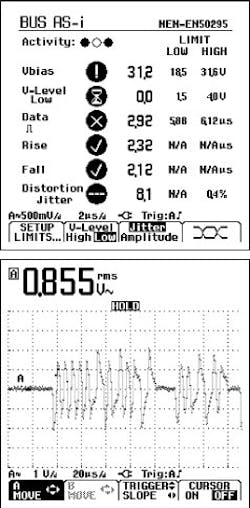

Ethernet checks — If it looks like a building-level or campus-level communications problem, take a look at the Ethernet network. A good first step is to verify operation by checking the network connectivity icons or Ethernet port link status LEDs. Next, use a network troubleshooting tool to quickly give you a broad overview of critical network performance parameters, including protocol alarms and errors, visibility of all switches and VLANs, routers, access points, and IP devices. The alarms, errors, and protocol information can help localize the problem down to a subnet, port, controller, or particular device.
Cabling checks — Once the problem is isolated, use a cable analyzer to check the cabling connecting the problematic devices. These tools will find common problems such as opens or shorts and will verify the cable's electrical performance. If the network is built on standard AWG cabling instead of twisted-pair cabling (UTP), then use a precision low-ohms digital multimeter to check for basic cable opens, shorts, and impedance problems.
Signal checks — If the cabling checks out OK, then take a look at the quality of the communication signals traveling on the network by using an oscilloscope to capture the waveforms. The scope will help you determine whether signals are getting through at all, and (if they are) whether they are attenuated or too distorted to be read clearly, in which case, something is disturbing the line (Figure on page 12).
