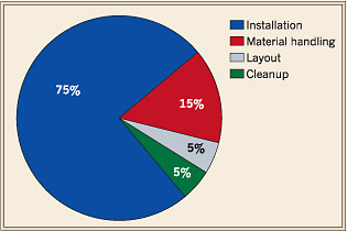

Types of estimates include conceptual, budgetary, design development, and unit price. The unit price estimate is the most accurate — and best suited for construction bidding. The unit price estimate is also a method of estimating. In the unit price estimate, you assign a price and a labor quantity to each item of material for a given set of installation conditions. These are called standard conditions, which form the benchmark for an estimate. For conditions outside the benchmark, such as increased height or restricted access, you must adjust labor accordingly. The unit price estimate, which requires a detailed set of plans and specifications with all of the design decisions made, can be broken into three parts: takeoff, extension, and summary. Let's take a look at the basics involved in each stage of the estimating process.
Takeoff. Takeoff is the science of quantifying the materials necessary to complete a job, as shown on the plans and as specified. At the heart of every good estimate is a good takeoff. The word “takeoff” comes from the action of “removing” the material from a set of plans, by marking with colored pencils or highlighters, until all of the materials are taken off. The takeoff is colored to identify various sections of the estimate, such as lighting, distribution, or feeders. Takeoff is finished when all the materials have been “taken off” the plan sheets, and listed on takeoff forms (or entered into the computer). The takeoff process also includes quantifying sheet notes and indistinct items, such as rigging or testing. Most electrical takeoffs consist of eight basic sections: lighting, distribution, devices, branch circuits, equipment circuits, feeder circuits, site work, and special systems. Although other sections on a project may include emergency generators, cable trays, or fiber-optic systems, the procedure stays the same.
All good estimators follow an orderly process and a consistent routine when completing the takeoff, which minimizes errors and omissions. Count the simplest or most common items first, the more complex ones next, and the sophisticated elements last. Following this sequence of takeoff can yield additional benefits as well. For example, by counting light fixtures first, you can get a complete “walk through” of the job — and in the process become familiar with the building construction, elevations, and room layouts. This will be very helpful as you progress through the other sections of the job. After counts, move on to length measurements, such as branch and equipment circuits. Because feeder circuits are the most expensive, routing can have a significant impact on total cost. Accordingly, feeders are typically saved until the end so that you can use maximum building data to figure the best route for takeoff. Lastly, move on to calculated measurements, such as site work excavation and concrete work.
As you prepare for the takeoff, you should understand the “standard conditions” for the work your team will be performing. Only when you're thoroughly familiar with the standard conditions can the labor and materials properly be adjusted for the actual job conditions. For example, let's say your company's standard installation conditions for a 1-foot by 4-foot fluorescent lighting strip fixture include a mounting height up to 15 feet. However, the project you're estimating indicates these fixtures must be mounted at a height of 25 feet. Therefore, you must adjust the labor unit for the increase in height (labor units are a decimal expression of manhours). See Fig. 1 for typical labor unit components.

Extension. Once the takeoff is finished and all the right quantities of all the right materials have been accounted for, you can move on to the extension phase of the estimate. Extension activities consist of:
  • Extending the assemblies to component items.
  • Extending the item material prices.
  • Extending the item labor units, as adjusted during the takeoff.
  • Calculating labor rates, crew makeup, and composite labor rate.
  • Carrying the extended totals to the summary.
Takeoff usually is done by assemblies, which must be extended to items for pricing and laboring. This can be done manually with pricing forms and an adding machine or by computer. The manual method is time consuming and prone to error, but is very basic. Using a computer will speed the process and yield greater accuracy. The benefits of a good software program cannot be overemphasized and will typically pay for itself many times over.
The same concept applies to extending item material prices and item labor units. Pricing forms for extending material and labor are easily obtainable. However, computer templates save time and help eliminate math errors. Obtain material prices from the purchasing department or from current supplier quotes. Base labor units on company historical data. Companies that do not maintain historical data and productivity rates are destined to lose jobs by submitting bids that are too high — or too low.
When calculating labor rates, include all applicable labor costs, such as fringe benefits, taxes, insurances, and expenses. Fringe benefits should include all required costs for health and welfare, pension, training, and vacation. Taxes include social security (FICA), federal and state unemployment tax (FUTA and SUTA), and any local taxes. Insurance costs include workman's compensation, general liability (labor portion), and builders' risk or umbrella insurance. Labor-driven expenses include small tools, trucks, and “other” expenses calculated as a direct function of labor.
Labor rates are calculated for each field classification such as foreman, journeyman, and apprentice (see Table). Determine the crew makeup from consulting with the superintendent and then spread out the total manhours over the project schedule (Fig. 2). Applying the crew makeup to the labor rates, you can compute the project composite rate.
