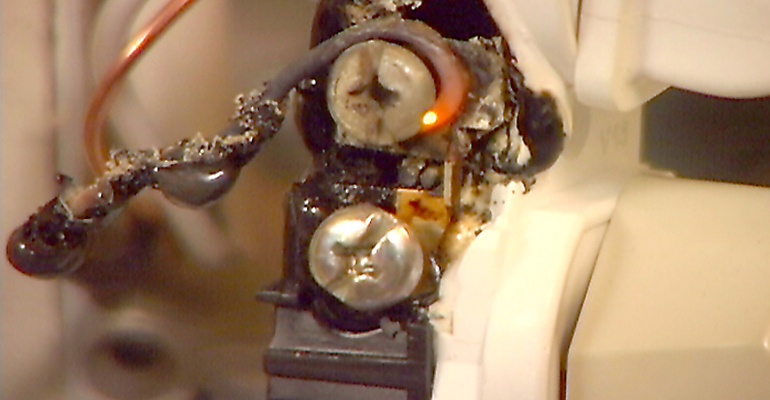

Poor connections can be very efficient at overheating, because they can generate a high wattage over a small area for a long period of time. This is evidenced in the research from William J. Meese and Robert W. Beausoliel in the “Exploratory Study of Glowing Electrical Connections,” published by the National Bureau of Standards, and NFPA 921, the “Guide for Fire and Explosion Investigations” from NFPA. If the watt density is high enough, the connection will glow. An oxide actually forms at the (loose) contact area, and the resistance of the oxide causes the I2R power dissipation.
Photo 1 shows a glowing connection at a common receptacle with a current of 12A with a 12 AWG conductor. If we're lucky, proper enclosing of these connections will keep an occurrence like this from igniting nearby combustibles, such as wood and cellulose insulation. Even though a poor connection is hazardous, there is currently no way to detect a poor connection as soon as it begins. A GFCI or AFCI may sense a poor connection after some electrical insulation becomes conductive and leakage current occurs (5 mA or 30 mA, respectively).
The red circles in Photo 2 show evidence of oxide buildup and small areas of melting due to the series arcing on the wire and the underside of the screw.
