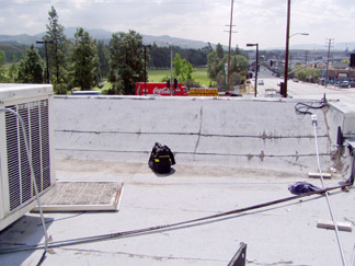

This fatality occurred while the decedent was installing an A/C unit for a retail tenant in a strip mall — the wood frame/stucco building of which dated back to the early '50s. The roof rafters served as the ceiling joists of the occupancies. The branch circuit wiring of the building was heavy wall steel flexible metallic conduit, which served as the equipment grounding conductor. The building was built in a large city jurisdiction whose electrical code preceded the general adoption of the National Electrical Code (NEC). As is always required, the local code was more restrictive than the NEC. Therefore, the applicable code at that time was similar to current editions of the NEC.
Each occupancy had a junction box installed in the fascia for a sign installation. In order to get a fascia for signage, the building's roof was elevated approximately 3 ft at a 40° angle near the front of the building (Photo 1). The roofing was of the hot mopped roll roofing variety, and the top edge of the incline was covered with a sheet metal cap. The building's service entrance was a factory-built switchgear consisting of a 120/240V single-phase service as well as 240V 3-phase service. The grounding conductor of these units had illegally cut strands to fit into the improperly sized ground clamp. The roof area, which was accessible via a permanent metal ladder, housed electrical work plagued by several Code violations that had existed for some time.

While atop the roof working on cutting the hole required for the package, the A/C installer needed some additional materials. He called down to his helper, who was at ground level, for assistance. The helper prepared the sheet metal fitting needed and got ready to hand the item to the installer from a ladder that did not reach the roof. Subsequently, the installer placed himself on the sloped roofing in a lying position (with his chest resting on the sheet metal cap, as shown in Photo 1 on page 8) so he could reach the item being handed up to him.
When the installer reached over the roof to lift the material, he touched the store's sign, causing a current to flow from his hand to his chest. Evidently, when the installer was electrocuted, his body reaction caused him to roll off the elevated section of roofing, thereby breaking the circuit.
