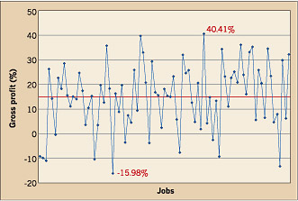

Figure 1 shows a representative contractor's percentage of gross profits by job. The spread between a job's outcomes could be a 40% profit or a 15% loss. This difference between potential profit and loss is far too big to allow for reliable and accurate job performance-based estimates. In this example, the standard deviation is 13.4%, indicating that the next job might earn as high as 28.1% or as low as 1.3% gross profits (on average). On a $100,000 job, this is a potential difference between earning a profit of $28,100 or $1,300. A $1 million job would have an expected profit of either $280,000 or $13,000 — a $267,000 difference!
