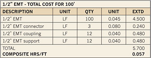

An example of an assembly is shown in Table 1 for ½-inch EMT, and includes the couplings, connectors, and supports, with averages for placement. The rates were taken from the NECA manual of labor units. This assembly arrives at a composite rate for ½-inch EMT of 0.057 hours per foot. The next step is to summarize the individual assemblies into composite units. Table 2 shows a typical example of how these would look. Each company will have their individual assemblies and rates used for estimating, which determines where their production targets need to be.

There are two ways to handle this. The first is impractical and involves tracking how much time is spent on each of these different items by person and then checking the production for each item. The second is to create a common unit and have multipliers for all other units to convert them (Table 3). This is no different than converting cubic feet to cubic yards by dividing the cubic feet by 27. In this case, we will choose 1 foot of ½-inch EMT as our common unit, and call it a “branch foot.” To convert other units into a branch foot, we assign a multiplier, which is determined by dividing the labor unit by the ½-inch EMT labor unit.
For example, to create the multiplier for ¾-inch EMT, we would take the ¾-inch EMT unit of 0.064 and divide it by the common unit (½-inch EMT) of 0.057. Rounding to the nearest single decimal is recommended for ease of use in the field. This multiplier comes out to 1.1, which means that running 10 feet of ¾-inch EMT is about the same as running 11 feet of ½-inch EMT.

Determining target production figure is pretty simple. Let's use ½-inch EMT as an example.
  • Common unit = ½-inch EMT/foot (branch foot)
  • Hours per common unit = 0.057
  • Average labor rate = $37.50/hr (from est.)
  • Minimum production = $2.13/ft (0.057 × $37.50)
Therefore, your target production is $2.13 per branch foot.
