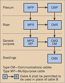

Table 800.50 lists multipurpose cables above communications cables because you can substitute multipurpose cables for communications cables. NEC Table 800.53 lists communications cable types and their respective permitted substitution (Table 2). You'll also find an easy-to-use substitution hierarchy in NEC Figure 800.53 (Fig. 1).

Note that Table 770.50 lists nonconductive optical fiber cables above conductive cables; you can substitute the former cables for the latter. NEC Table 770.53 lists optical fiber cable types and their respective permitted substitution (Table 4 above). You'll also find an easy-to-use substitution hierarchy in Figure 770.53 (Fig. 2 below).
