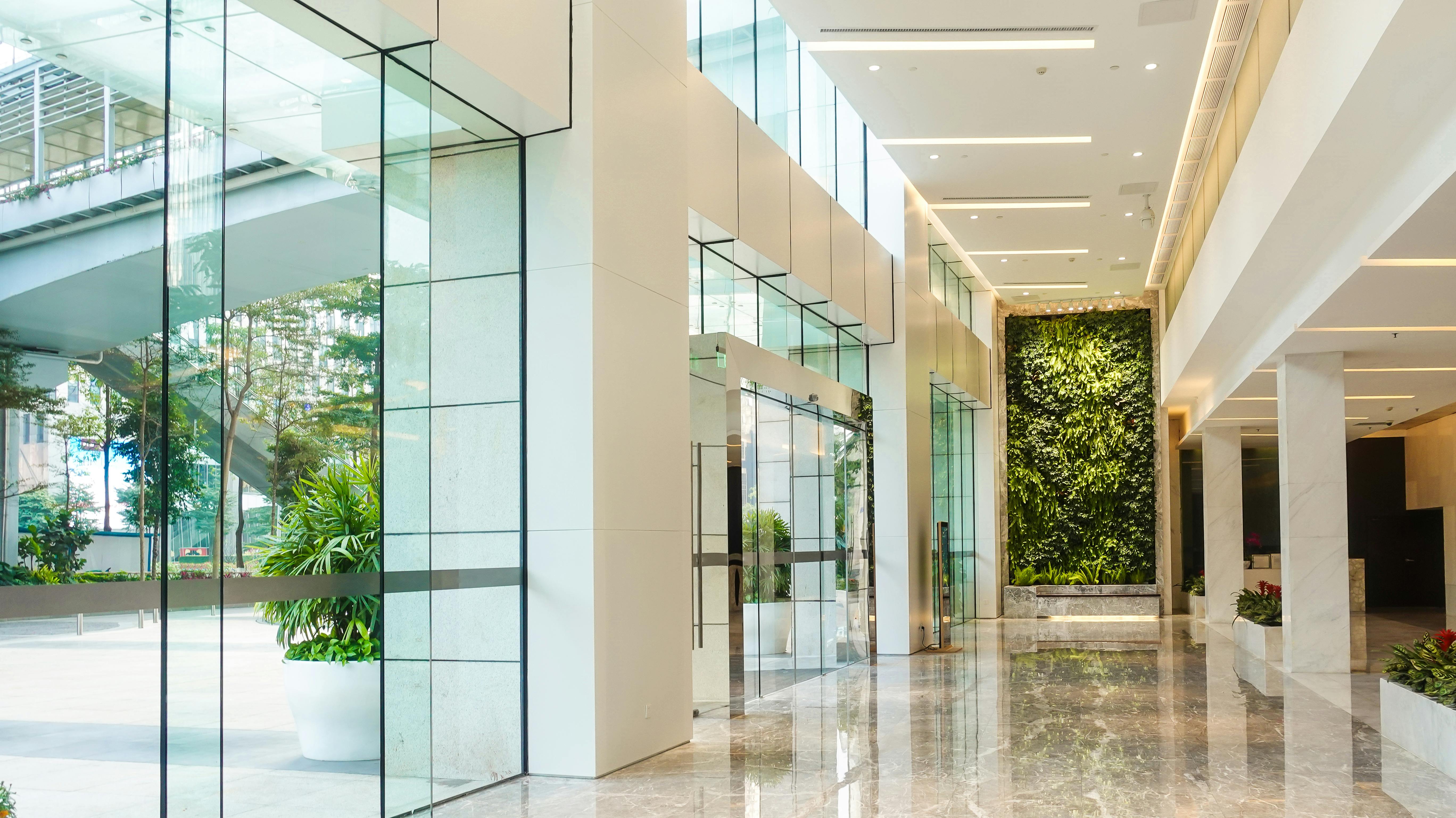

The 2021 IECC specifies changes aimed at reducing lighting energy consumption in commercial and residential buildings. The most significant change is a reduction in lighting power allowance (Sec. C405.3.2) for most building types. For example, the hospital lumen power density (LPD) dropped minimally from 1.05W/ft2 to 0.96W/ft2, while museums dropped significantly from 1.06W/ft2 to 0.55W/ft2, as shown in Photo 1.
