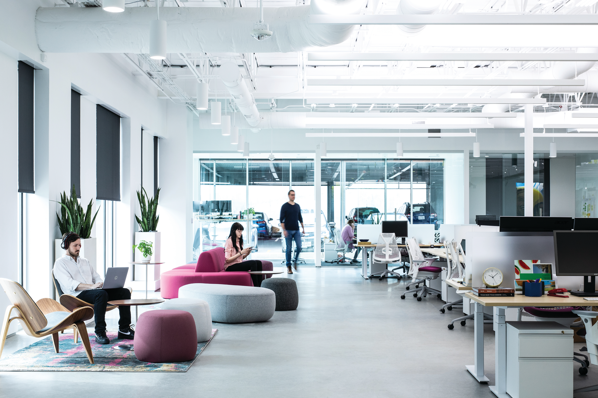

  • Open office lighting — In zones of 600 ft2 or less, lighting must be partially off (or fully off) when the zone is vacant.
