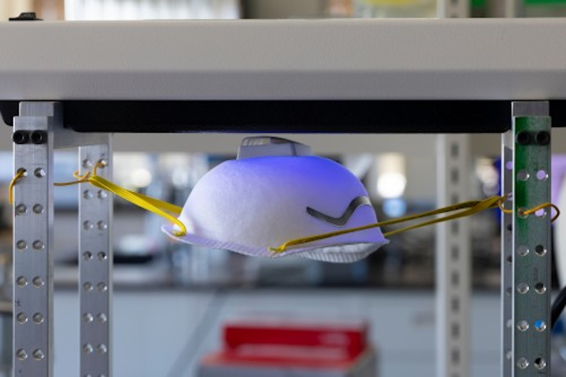

Kaiming Ye and Guy German from Binghamton University, State University of New York, developed a machine to disinfect personal protective equipment such as facemasks.

The idea for the research came when shortages of personal protective equipment (PPE) early in the pandemic inspired Ye, German and Binghamton University staff members to quickly build UV disinfection stations for hospitals in the region, so that N-95 masks and other items could be reused.
