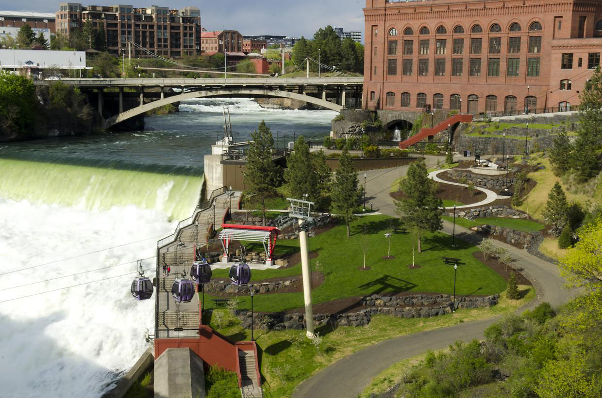

Parks such as Spokane, Wash.’s recently renovated Huntington Park on the Spokane River extends down the hillside, which places lighting poles along a meandering path — far from the source of electricity. In cases like this, precise voltage drop calculations are critical.

On many projects, it often becomes necessary to branch out perpendicularly from a single string of luminaires rather than run along a fairly straight and long line. The lighting layout in Spokane’s Huntington Park (see Photo) is a good example of this type of arrangement. The one-line diagram for this specific project (Fig. 1) resembles a tree shape. However, not all designers will approach sizing the required conductors in the same way. If the designer is still using traditional rules of thumb, the result could add significant cost to the project. Let’s assume the following with regard to this particular project:
