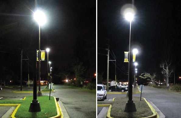

Photo 2. Metal-halide (MH) vs. LED street lighting.
Photo 2 provides an approximation of the difference between the metal-halide (MH) lights and the retrofit LED lights for the parking lot. The photographs highlight the fact that although the illumination appears roughly equal, the LED lights consumed about 117W, whereas the MH lights consumed about 222W, a calculated power savings of 105W per fixture. The MH photograph was taken in the summer, and the LED photograph was taken in the winter, which explains the difference in grass color. The LED fixture has a higher color temperature than the MH, which is evident by the whiter, almost blue color emitted from the fixture. In addition to appearing whiter, the light output from the LED fixtures appears to be more even on the ground. This observation was verified by the photometric design received from the manufacturer and measurements taken by the Scotty. During 15 months of site monitoring, measurements taken by the Scotty indicated no significant degradation of the light level.
