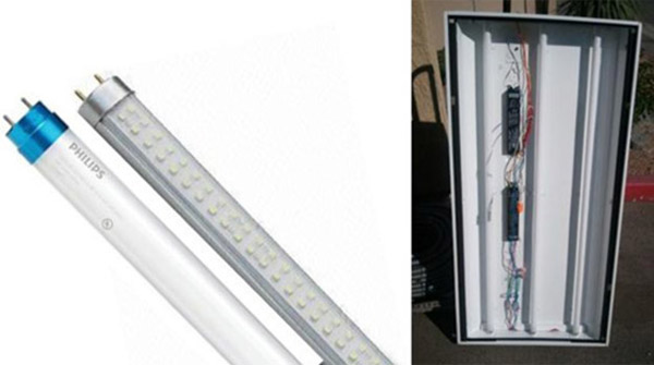

Diffuse and clear LED T8 tubes (left), the interior of a fluorescent troffer (center), and an LED retrofit kit (right) that includes the LED boards, driver, and a new diffuser for the aperture of the original troffer.

Another issue noted by the study was that most LED T8 replacement lamps — which, unlike omnidirectional fluorescent tubes, emit no light from their back sides — caused the appearance of stripes on the lenses of troffers by increasing the luminance contrast between the lamp and the unlighted reflector behind it. As for dimming, neither the LED products nor the fluorescents were found to dim smoothly and predictably, and roughly one-third of the LED products exhibited annoying flicker in dimmed mode.

A number of issues were encountered during the installation of the LED products. For LED retrofit tubes, there wasn’t enough wire in some troffers to reach across the fixture, once the ballast was cut out. Some LED tubes came with stickers to warn against reinstalling T8 fluorescent tubes in the modified fixture, but electricians didn’t use those stickers if the instructions made no mention of them. LED tubes from two manufacturers featured rotatable pins in the socket to orient the tubes inside the troffer, but seating and rotating the tubes in the socket was found to be quite challenging. Some kits lacked sleeving or other pieces that were referred to in the instruction sheets. The catalog numbers of one manufacturer were at variance with the numbers on the actual products.
For LED non-tube retrofit kits, those that directed the installer to discard the fluorescent sockets (“tombstones”) and install bars of LEDs instead of tubes were found to require a lot less labor than reusing the sockets. One kit provided stranded wire for push connectors, despite the fact that solid wire would not only have been easier to install but would have provided a more secure connection. Another kit had a different manufacturer’s name on the instruction sheets from the name on the actual hardware. The need for some non-tube retrofit kits to be installed in deeper troffer housings wasn’t noted prominently enough on the specification sheet. Some lenses and surfaces came with protective film to minimize scratching, but the instructions suggested removing the film before the risk of scratching was eliminated. Overall, an electrical inspector could have disqualified more than half of the installed LED tubes and non-tube LED retrofit kits because of either poor assembly or lack of safety documentation.
