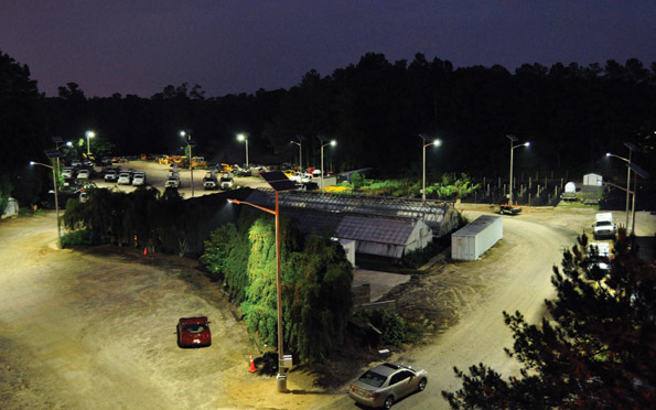

Solar-powered LED lighting at Marsh Creek Maintenance Yard, Raleigh, N.C.
