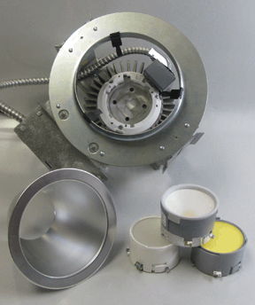

The first specification was approved in February 2011 for a socketable light engine with integrated control gear (Photo 1) for use mainly in downlights. Several companies provided prototypes and input to the development of the light engine and mating holder (Photo 2). The design creates a large thermal interface between the light engine and heat sink to enable the long-life and performance expected of LEDs, with the replacement as easy as a quick twist.
