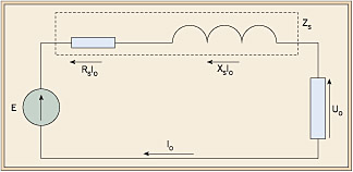

Theoretically, for any supply line, the voltage at the load end is different from that at the source. We can demonstrate this with a per-phase equivalent circuit, as shown in Fig. 2. Here, E is the source voltage, RS is the equivalent line resistance, XS is the equivalent line reactance, ZS is the equivalent line impedance, IO is the current, and UO is the voltage at the load terminals.
Depending on its cause, a voltage change can take the form of a voltage drop having a constant value over a long time interval, a slow or rapid voltage change, or a voltage fluctuation.
