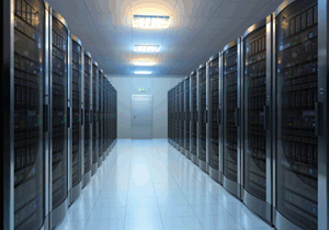

Information technology equipment (ITE) consumes approximately 4% of all electric power in the world. In fact, most businesses cannot exist without ITE. When it comes to working in spaces that contain this type of equipment, many electrical designers and installers have been tripped up on what Code rules apply. In 2011, the National Electrical Code (NEC) introduced some major changes for areas identified as ITE spaces per Art. 645. Key changes to be noted in this version of the NEC include:

One of the main reasons an owner would want a data center classified as an ITE space under Art. 645 is to get the relaxation permitted for certain listed under-floor power supply cables in 645.5(E). Historically, ITE spaces have been identified by a raised floor, which has been used both for cooling and for running interconnecting cables between ITE-listed power distribution units (PDUs) and IT equipment (which can be 50 ft or more away from the PDU). ITE (such as a server) is usually plugged into a listed rack-mounted power strip, which then plugs via an attachment cord into a connector or outlet box under the floor. Such boxes or enclosures can now be either metallic or nonmetallic.
Table 645.5 identifies the types of plenum, riser, and general-purpose cables permitted under raised floor, generally for signaling purposes. 645.5(E)(3) specifically permits the supply cords of listed ITE to plug into the connectors, boxes, or enclosures under the floor, even though the cords are not “plenum rated.” Per 645.5(B)(1), supply cords can be no longer than 15 ft long. In addition, 645.5(F) says the following cable types do not have to be secured in place when listed as part of, or for, IT equipment:
