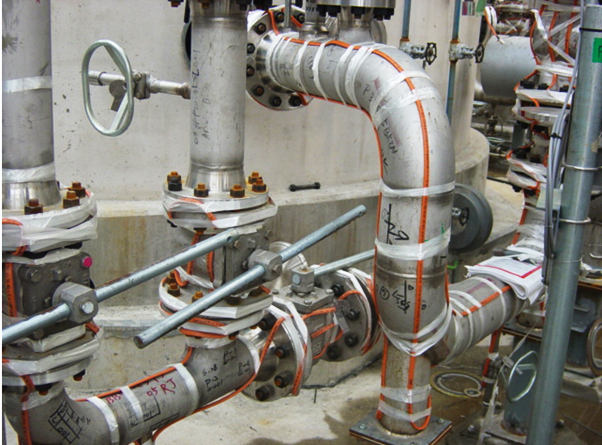

Typical installation utilizing self-regulating heater cable.

Installation of the self-regulating heater cable is similar to other types of heater cables. The cable is typically attached to process piping with a self-adhesive glass fiber tape (see Photo). For attaching to equipment or other irregular surfaces, it is common to apply self-adhesive aluminum tape on top of the heater cable.
In contrast to series-resistance type cables, self-regulating cables may overlap onto themselves without the risk of overheating and burning out at the point of contact. This is beneficial when a large quantity of cable must be placed onto a valve or other item with limited surface area.
