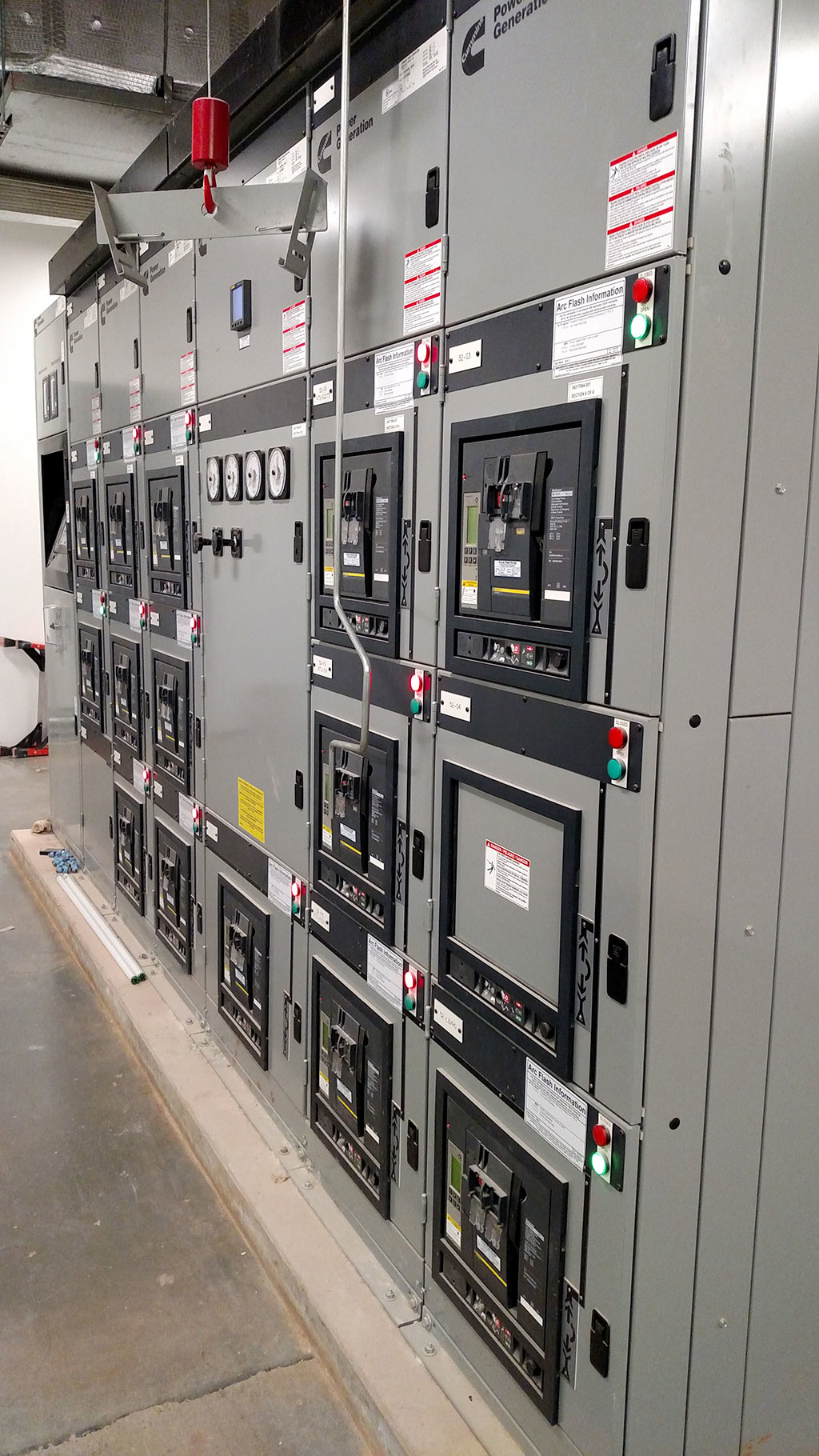

As I always say: Code minimum is code minimum — and not necessarily best practice nor standard of care. But now back to the real topic — which came first? The discussion always starts: How can I submit equipment for you to review if I don’t know if it coordinates? The reply is typically: How do you know it coordinates if you don’t submit equipment for the coordination study? It seems like a never-ending loop, doesn’t it? The second question typically is: If you don’t know what equipment will coordinate, what did you design, and what did you specify?
Reality is that engineers actually do have a general sense of what equipment will coordinate; we use the old “fuse thumb rule of 2 to 1,” but the final coordination of each specific piece of equipment is based upon a myriad of factors.
One of the primary differentiators is the manufacturer. Each manufacturer has different coordination curves for each fuse size and type, breaker type, frame size, and trip rating of their own equipment. A 400A breaker for one manufacturer could coordinate with a 600A breaker, but for an alternate manufacturer the frame size for the breaker may need to increase to an 800A frame to permit the system to selectively coordinate. Making this modification could change the type of panel the breaker is installed in, the physical size of the panel, and subsequent breakers upstream and downstream. Available fault current also can impact how overcurrent devices coordinate with each other. Most manufacturers have tables where they have tested breakers in series (not series rated breakers — that’s a different topic) for defined levels of available fault current. This could allow breakers that do not coordinate “on the curves” (aka onion skins) to coordinate at a defined fault current level. Feeder length also makes a difference, as do any pieces of equipment in line between two OCPDs. A longer feeder or a transformer will drop your available fault current and may allow additional devices to be coordinated solely based upon the tested tables for the available fault current.
The NEC requires a selective coordination study to be implemented by a licensed engineer. The design engineer typically runs a preliminary study with one manufacturer’s equipment and estimated feeder lengths. This study is what the engineering design is based upon, and modifications of the distribution system are made where applicable. Once the project is bid and awarded, the onus of running the study with the anticipated equipment and feeder lengths shifts to the electrical contractor. Typically, the contractor engages the chosen manufacturer to run the study using their equipment to confirm breaker size, settings, available fault current, and arc flash levels. Most manufacturers have an engineering department with licensed engineers whose primary responsibility is to create these studies. Once the study is completed, it is submitted to the engineer for review to assure all of the design parameters and code compliance requirements are met. The study also recommends modifications to the submitted equipment if frame sizes or fault current values are required to be changed to achieve coordination. There are typically at least two rounds of submittal reviews prior to approval of the study and subsequently the electrical distribution equipment. Be mindful that actual available fault current from the electric utility and specific generator information are also required to create a valid study.
So what’s the answer to the question, “What came first — the distribution equipment or the coordination study?” That’s simple — they both walked across the street together.
