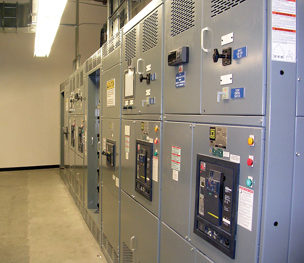

Electrical commissioning of complex electrical distribution systems adds value and peace of mind to facility owners. By thoroughly commissioning the electrical system, the facility owner is assured that the complete system will operate as intended when reliability and continuity of power is needed most. In addition to knowing the system will support the critical loads during an emergency event, such as a power outage, the facility owner can count on the overall system performing when one generator fails or is down for maintenance. Finally, he or she knows how long the uninterruptible power supply (UPS) can provide power — and that it will not drop the critical loads when placed in maintenance bypass mode.
Testing of emergency distribution switchgear is a critical step in the electrical commissioning process.
