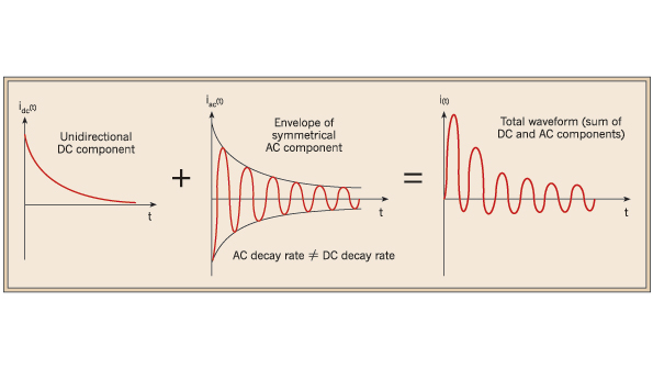

Fig. 1. Components of asymmetrical short circuit current waveform.
Figure 1 (above) illustrates a typical short circuit current waveform for one phase of a 3-phase synchronous generator, previously unloaded, which has been subjected to a bolted 3-phase short circuit across its accessible terminals. The asymmetrical short circuit current waveform can be broken down into two components: 1) a unidirectional (DC) component; and 2) a symmetrical alternating (AC) component. The DC component exponentially decays to zero, while the envelope of the symmetrical AC component eventually decays to a constant amplitude sine wave in the steady-state. The rate of exponential decay (or time constant) of the DC component is related to the short circuit X/R ratio, where X and R are the equivalent reactance and resistance at the fault location, respectively. To simplify analysis, steady-state AC circuit theory is exploited to calculate a worst-case (initial) root-mean-square (rms) magnitude of the symmetrical AC component to characterize a particular time interval of the fault-on time period. To simplify verbiage, the expression “worst-case (initial) root-mean-square (rms) magnitude of the symmetrical AC component” is hereafter shortened to “symmetrical rms current.”
Three types of networks are used to represent the power system over three time intervals of the fault-on time period. The first-cycle (momentary) network characterizes the first few cycles (at 60 Hz) of the fault-on time period. For this network, the AC motors and generators are modeled by first-cycle or subtransient reactances, and steady-state AC circuit analysis is used to calculate the first-cycle (momentary) symmetrical rms current. To account for the DC component of the short circuit current waveform, the first-cycle (momentary) symmetrical rms current is multiplied by an appropriate multiplying factor (MF) to yield the first-cycle (momentary) short circuit current duty; and first-cycle (momentary) short circuit duties must not exceed: (i) closing and latching (momentary) capabilities of medium-voltage circuit breakers, (ii) interrupting capabilities of medium-voltage fuses, (iii) interrupting capabilities of low-voltage circuit breakers, and (iv) interrupting capabilities of low-voltage fuses. The contact-parting (interrupting) network is used to calculate the contact-parting (interrupting) symmetrical rms current for medium-voltage circuit breaker minimum contact-parting times of 1.5 to 4 cycles after the inception of the short circuit fault. For this network, the AC motors and generators are represented by different (same or larger) constant reactances than those for the first-cycle (momentary) network. To account for the DC component of the short circuit current waveform, the contact-parting (interrupting) symmetrical rms current is multiplied by an appropriate MF to yield the contact-parting (interrupting) short circuit current duty; and contact-parting (interrupting) short circuit current duties must not exceed the interrupting capabilities of medium-voltage circuit breakers. Finally, the approximately 30 cycle network is a minimum source representation that characterizes the faulted power system in the steady-state (beyond 30 cycles), and it is used to investigate whether minimum short circuit currents are sufficient to operate current-actuated relays.
