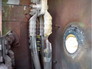

One potential deficit in 70E relates to the personal protective equipment (PPE) required when working on “exposed” versus “dead-front” equipment. The words “dead-front” refer to equipment with a solid barrier (usually metal panel covers), such that it has no exposed parts energized to 50V or more on the operating side of the enclosure. The circuit breaker panel included in most newer homes is a good example of a dead-front installation. Opening the access door on the circuit breaker panel reveals only dielectric (non-conductive) circuit breakers, a solid metal door that completely covers the circuit breakers, and the rest of the panel opening.
This dead-front is primarily designed to protect the homeowner from direct exposure to the energized elements inside the enclosure. There is considerable evidence that arcing faults can burn through the enclosure cover or sides (Photo) and injure workers/cause fires.

  1. Electrical arcs will exit the equipment through any opening in the enclosure. Many enclosures contain cooling vents that are necessary to keep the internal components within temperature limits for normal operation. Anyone standing in front of the equipment when an arc occurs within could be burned by the arc exiting the enclosure through these openings. Note: It is important never to seal cooling vents in enclosures, as they do serve an important function in the operability of the equipment. Results of arcing also include possible fires.
  2. Arcs that last longer than a few seconds can easily generate heat levels that will breach the enclosure and still present a hazard to workers in close proximity to the gear. The arc duration is determined by the length of time it takes for the arc to either operate OCPD or to consume (electrically) the metal in the faulted circuit.
  3. The blast generated by the arc can cause the doors of the enclosure to burst open, again exposing anyone standing in front of the equipment to physical trauma. An inspection of typical metal-clad electrical enclosures reveals that the back side of the gear is often secured by four to 10 hardened steel bolts while the access door is often held in the closed position by only two or three “convenience latches,” where a tongue-like metal latch merely slides underneath the lip of the door frame to secure the door. These latches are good when a lock is inserted to prevent the casual access to the interior. However, they're often not able to contain the possible arc blast. They are by far the most likely component of the enclosure to fail when subjected to an arc blast.
