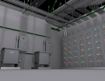

An early milestone in Dynalectric's use of BIM was a $25-million project to upgrade the Hollywood Bowl in 2003. Designed by Hodgetts + Fung architects, the project included a reconception of the arch, advanced digital sound reinforcement system, and expanded stage with a halo-like acoustic canopy. Dynalectric used BIM to model 25,000 ft of conduit running through a complex “forest” of structural steel. Although the electrical BIM model was complex, it was still a rudimentary conduit model by today's standards. Yet, it was only through the use of BIM that the electrical contract could have been effectively planned and executed. Using 2D sections and elevations to try to understand the structure in the traditional method would have made it nearly impossible to effectively find a routing for all the required systems.
In 2005, Dynalectric was still the only contractor using BIM on the new Four Seasons Hotel and Spa Westlake Village, Calif., which was designed by WATG architects for owners Castle & Cook, Inc. More than 750,000 ft of conduit and support systems were routed for this six-story, 476,000-sq-ft structure, which includes 268 guest rooms, a spa, wellness center, TV studio, clinic, and conference center.
The Dynalectric team began by looking at the primary electrical service that was entering the main electrical room (Photo 2). The single line specified (20) 4-in. conduits for the two 4,000A primary feeds into the building. These raceways were routed to an already undersized and overcrowded electrical room. By modeling this area, the team was able to quickly identify the problems and clearly demonstrate the issues to the designers. For example, the staff suggested replacing more than 13 sq ft of conduit with 1.2 sq ft of busway, freeing up a large amount of space in an already congested space at no additional cost.
It is also noteworthy that more than 3,500 anchors were embedded into the structure for conduit support systems. Due to the accuracy of the model, Dynalectric was able to use 99% of these anchors.
