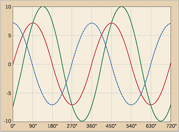

There is a time difference or phase angle between voltage and current waveforms, and cos U reflects the PF caused by the phase angle. For instance, a 45° displacement equates to a 0.707 displacement PF. Figure 1 shows PF correction of sinusoidal, displaced waveforms. The green trace is a 45° lagging waveform from an inductive load; the blue dashed line is a 90° offsetting waveform from shunt capacitance; and the red trace is the corrected in-phase waveform. The amplitude of the corrected waveform (red) is smaller than the original waveform (green) because the inductive components are balanced out. You can calculate the offsetting current by using the following equation:
Icorrection = sin U × Idisplacement
In this case, sin U = 0.707, so the offsetting current is 7.07 (10 × 0.707).
