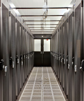

1. High-density design
Data centers already are moving toward high-density computing environments as newer, more dense servers are deployed. It’s important to note, however, that moving to a high-density computing environment does require a different approach to infrastructure design, including:
High-density cooling: Placing high-efficiency cooling units closer to the source of heat (e.g., near the rack) complements the base room air-conditioning system. These systems can reduce cooling power consumption by as much as 32% compared to traditional room-only designs. High-density cooling systems have become a basic building block of the data center of the future, delivering the ability to meet the needs of today’s 10kW, 20kW, and 30kW racks while offering the ability to support densities of 60kW or higher in the future.
Intelligent aisle containment: The efficient and well-established practice of hot/cold aisle alignments sets up another movement — containment. Aisle containment prevents the mixing of hot and cold air to improve cooling efficiency. Both hot-aisle and cold-aisle containment systems are available.
High-density power distribution: Power distribution has evolved from single-stage to two-stage designs to enable increased density, reduced cabling and more effective use of data center space. Single-stage distribution often is unable to support the number of devices in today’s data center as breaker space is expended long before system capacity is reached. Two-stage distribution eliminates this limitation by separating deliverable capacity and physical distribution capability into subsystems.
The first stage receives high-voltage power from the UPS and can be configured with a mix of circuit and branch-level distribution breakers. The second stage or load-level units can be tailored to the requirements of specific racks or rows. Growing density can be supported by adding breakers to the primary distribution unit and adding additional load-level distribution units.
