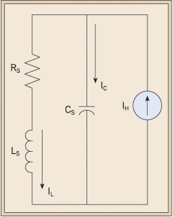

Capacitors are static or linear components, and they do not generate harmonics. However, they will interact with the electrical system source inductance and may create a parallel resonance condition at a troublesome harmonic. See Fig. 1 (click here to see Fig. 1) for a simple typical one-line diagram.
A simplified circuit model is shown in Fig. 2 (click here to see Fig. 2). Motors have high inductive impedance compared to the source impedance; therefore, we will ignore them in our circuit.
Combining transformer and electric utility source impedances is shown as RS and LS in Fig. 3. The shunt capacitance of the power factor correction capacitors is represented as CS.
In Fig. 3, the model has been rearranged for harmonic analysis and to emphasize the parallel L-C configuration with a harmonic current source.
If the circuit is resonant at a frequency in which harmonic currents are being injected by the load, circulating currents (IL & IC) will be approximately equal in magnitude and can be many times greater than the harmonic source IH.
Voltages across LS and CS can become large. This increase in current IC may cause fuses to blow, or the resulting higher voltages across the capacitors may cause the capacitor to fail or possibly rupture.

With the addition of power factor correction capacitors, a troublesome parallel resonance can be created. This may be an isolated bank or another bank added to the system. If a bank is already on the system, adding more capacitors could move the parallel resonance to a lower troublesome harmonic. The parallel resonant harmonic (HR) for a system can be calculated from:
Where:
HR = resonant frequency as a multiple of the fundamental frequency.
MVASC = short circuit current at the point of study
MVARC = shunt capacitor rating at the point of study
If it is determined that parallel resonance near a characteristic harmonic will occur (such as the 5th or the 7th), then mitigation may be required. This is usually accomplished with “detuning” the parallel resonance with a harmonic filter/capacitor package.
For a 6-pulse harmonic source, the filter design typically includes a reactor placed in series with the capacitors such that they are tuned at a chosen harmonic (i.e., the 3.8th, 4.2nd , 4.7th, etc.).
