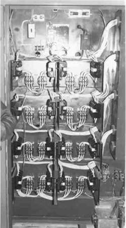

Two 480V, 3-phase 1,500A feeders supplied power to separate control cabinets. A 1 kVA, 480/120V transformer provided the control power for the system via a transfer switch connected to the 480V feeder. The boiler contained 225 resistance heater units rated at 10kW each. These were connected in 75 delta loads for a total load of 2,250kW. A 3-pole contactor controlled each delta load. Photo 1 shows one of four panels that housed these contactors. A 20-step controller from Manufacturer B (Photo 2) operated the contactors in groups of three or four to modulate the heat rate for the boiler system to match the required heating load. If the temperature of the hot water deviated from the specified set point, the step controller would increase or decrease the heat rate accordingly. With sensors to shut down the unit in the event of a low-water or over-temperature condition, the boiler was designed to “reset to zero heat rate” in case of a shutdown.

After thoroughly testing the original limit switch, I found it to meet all of the operational specifications of Manufacturer B for that particular component. I calculated the inrush current of the 3-pole power contactors to be 0.5A. Thus, if all contactors were simultaneously energized, the 1kVA control transformer was loaded to 375%.
Standard open-circuit/short-circuit testing methods determined the impedance of the control transformer referred to the low side as 0.879 ohms. If 76 contactors were energized simultaneously and the available control voltage was 110V, then the voltage at the coil of the contactors would be 76V, which is 12V less than the “pull-in voltage” for these contactors. Thus, for some heat rate setting less than full, the contactors would chatter rather than pull in solidly. This chattering would cause arcing, arcing would create ionization of the air, and ionization of the air would initiate ground-fault arcing from some of the components energized at 480V. The appearance of the burned cabinets is consistent with this theory.
