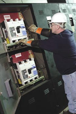

Interrupting rating is defined as the highest current at rated voltage that a device is intended to interrupt under standard test conditions. Where fuses or circuit breakers that don't have adequate interrupting ratings are misapplied, they can rupture violently and damage equipment. In addition, such an event can pose health hazards to personnel, such as damage to eyesight and hearing, as well as burns from flammable clothing.

Series-rated systems for existing facilities. Series-rated systems in existing facilities are covered by 240.86(A). Because building electrical systems may change — sometimes drastically — after the initial installation, it isn't uncommon for the increased available short-circuit current to exceed the interrupting rating of existing circuit breakers.
In many cases, existing electrical equipment isn't evaluated when a change is made to the service transformer or utility feed. The increased available short-circuit current may be a result of changes to the electrical system, including the addition of new transformers with a higher kVA rating, lowering the impedance of the new transformers (as compared to the transformers replaced), the use of higher efficiency transformers, and, in general, the addition of more loads. Therefore, it's important to do a thorough review of the short-circuit currents associated with the changes to the electrical system to avoid possible misapplication of the overcurrent devices.
Prior to the revision of 240.86 for the 2005 NEC, the only option available to the owner appeared to be replacement of the existing electrical equipment, including circuit breakers or fusible switches with adequate interrupting ratings for the increased available fault current. This is often cost prohibitive and disruptive. It can also place electrical workers in a very hazardous situation by making them work on or near energized, improperly rated equipment.
