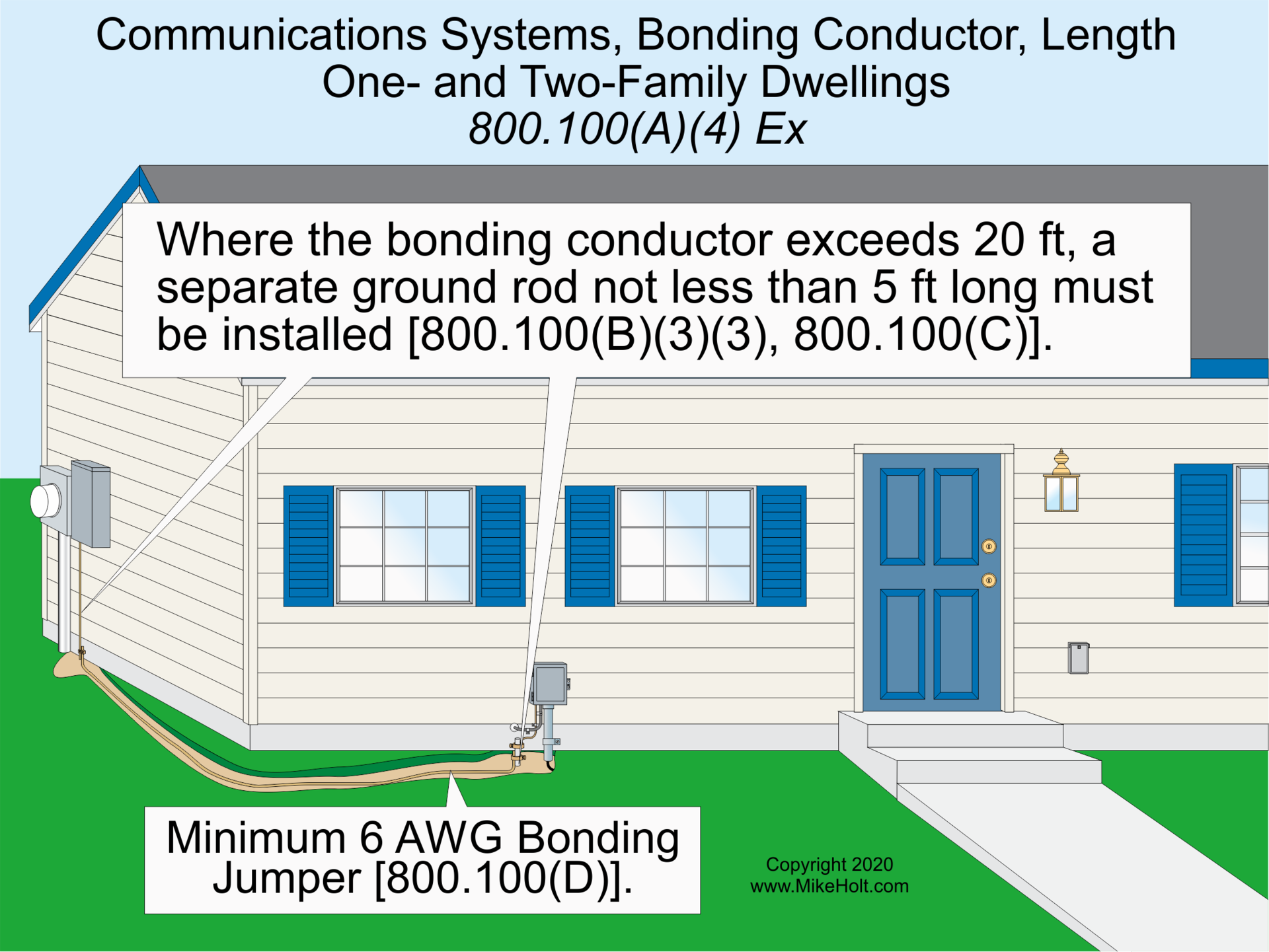

  • As short as practicable [Sec. 800.100(A)(4)]. For one and twofamily dwellings, the bonding conductor or grounding electrode conductor can’t exceed 20 ft in length. Exception: If the bonding conductor or grounding electrode conductor is more than 20 ft long for one and twofamily dwellings, a separate ground rod at least 5 ft long [Sec. 800.100(B)(3)(3)] with fittings suitable for the application [Sec. 800.100(C)] must be installed. The additional ground rod must be bonded to the power grounding electrode system with a minimum 6 AWG bonding jumper [Sec. 800.100(D)] (Fig. 1).

If a separate grounding electrode (such as a rod) is installed for a communications system, it must be bonded to the building’s power grounding electrode system with a minimum 6 AWG copper conductor [Sec. 800.100(D)].
