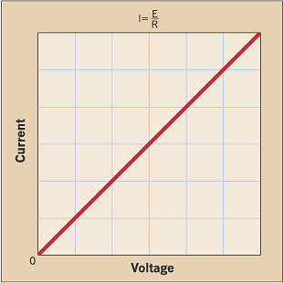

Pure resistance, inductance, and capacitance are all linear. What that means is if we place a sine wave voltage of a certain magnitude across a circuit containing pure resistance, the current in the circuit follows Ohm's Law: I = E ÷ R. So, for a specific value of ohms, the relationship of volts and amperes is a straight line (Fig. 1).
For example, let's say we apply 100V across a 10-ohm resistor. Per Ohm's Law, the current would then be 10A. If we double the voltage to 200V, the resulting current is 20A. For 400V, the current would be 40A, etc.
