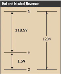

Reversed hot and neutral wires. Measuring hot-to-neutral voltage by itself doesn't tell you if those wires are reversed. You must measure neutral-to-ground or hot-to-ground voltage. If the neutral-to-ground is 120V and the hot-to-ground is a few volts or less, then the hot and neutral wires are reversed (Fig. 1).

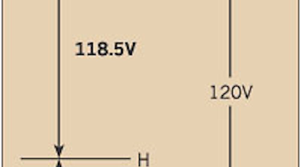

When you connect the load at the receptacle, the hot-to-ground receptacle source voltage should be the sum of the hot-to-neutral voltage (the voltage across the load) and the neutral-to-ground voltage (the voltage drop on the neutral wire all the way back to its connection to the ground circuit) (Fig. 2 on page 34).
