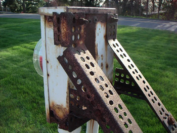

You can't see corrosion happening, but you can't miss its effects. Stop it before it starts.
Corrosion is one of nature's most destructive forces. Not only does it eat away at electrical devices and equipment, it eats away at productivity by causing power interruptions, downtime, and costly repairs. In fact, corrosion costs U.S. businesses, government agencies, and households more than $300 billion a year.
Corrosion is the gradual wearing away of any substance by a chemical, physical, or electrochemical reaction. Electrical systems corrosion usually takes place by means of a natural chemical reaction triggered by metal's inherent tendency to revert to its more stable compound, usually an oxide.
Some metals are more "active," or more likely to enter into a reaction, than others. So-called "Noble" metals, like gold and platinum, are so inactive that corrosion is negligible. Aluminum is active and corrodes quickly, but the thin, transparent layer of oxide that forms actually protects the metal from further corrosion. Iron, however, is extremely reactive. Left unprotected, it will erode, crack, and eventually fail.
