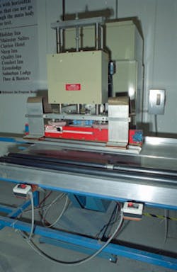

The RF sealer, shown in Photo 1 and Photo 2, contains an integrated high-frequency generator and set of operational controls. The RF emitter is embedded in the sealing die. The lower platen rides on a movable arm that slides on wheels across a solid table. Two control panels with push buttons are mounted in front of the base table on wooden offsets (Photo 3).
In the RF sealer, most of the high-frequency waves are directed down through the medium. Although movable, the sealing die and lower platen are bonded to the bedplate, providing a ground path and preventing large voltages from building up on other metal parts of the machine. Some of the bonding straps are shown in Photo 4. The bonding straps are specially shaped for maximum surface area to absorb the RF radiation.

According to his deposition, the worker was standing in front of the RF sealer at the time of the accident. As he simultaneously pushed the black buttons on each of the remote control boxes, he noticed a pop and flash emanating from underneath the table. At the same time, he received a severe shock to his left arm. Initially, he was unable to remove his hand from the button. Fortunately, his arm soon contracted, and he was thrown backward. Immediately taken to the hospital for examination, the victim was treated for a burn mark on his left hand. As time progressed, however, he suffered from tingling, numbness, and a loss of grip strength.

After extensive forensic investigation, we concluded that this case revolved around two possibilities for the origin of the shock hazard — both of which were tied to the damaged conduit and control conductors leading to the control box. At the time of the accident, the conduit was being used as a grounding path back to the RF generator. When the conduit was severed, so was the ground path. As the control boxes were mounted on a wood plate, they were electrically insulated from the RF generator and base table.
With this situation in place, if the control circuitry insulation was compromised and a bare conductor contacted the remaining conduit, the control box could become energized. If a worker touched the control panel, he or she could create a path to ground and be shocked. Unfortunately, because the original conduit and conductors were disposed of, no evidence of this type of arcing could be found. Although the RF generator contained 2.5A fuses on the control circuit, a current below this level could still injure a person and not blow the fuse.
Another possibility involved the high-frequency waves produced by the RF generator. As noted in SIDEBAR: Wave Basics, the localized, high-powered, high-frequency signals can induce voltages in conducting materials. With the damaged control panel conduit compromised — and the bonding plates damaged — the ground path back to the generator (and eventually earth ground) was compromised. When the RF signal was generated, it could then induce a voltage on the metal control panel box. As a result, when a worker touched the panel, he could create a path to ground with his body and be shocked.
