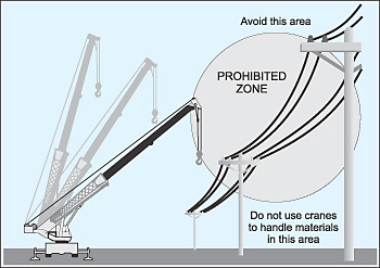

Two cranes were available on-site — a 75-foot crane with an insulated boom and a 170-foot crane with an uninsulated boom. Because the team needed to access a large area, it decided to use the larger crane. The power line conductors were about 50 feet above the ground, and once the crane was in place, they would be well within the reach of the elevated boom.
Drawing upon past experience, the crew placed the crane in what it thought was the appropriate place, set the outriggers, and per company safety rules, drove a ground rod that was connected to the crane via 4-0 wire. The crew assessed the risk posed by the power lines and decided to place spotters on a bluff about 300 feet from the area where the crane would be working. One spotter would provide proximity information to a second person tasked with radioing the information to a third person near the crane who would repeat the information to the crane operator. As it turned out, the spotters weren't positioned directly in line with the overhead lines and therefore didn't have an optimal view of the crane's proximity to the conductors. Also of note is that the crane's controls could be operated by a person standing on the ground next to the crane. This configuration created a parallel pathway for current to ground through the crane operator.

The first problem was the team's decision to use a crane with an uninsulated boom inside the 10-foot safe zone specified by the manufacturer. Had they used a crane with an insulated boom or maintained the 10-foot boundary, the operator wouldn't have been injured. However, given the team's choice, the accident still could have been prevented had the crane been modified to include an isolation platform and isolated controls that ensured the operator would be safely within an area of uniform voltage. Ohm's Law tells us that we can't be shocked or injured by electricity if we're held in an area of a singular voltage. Injury can only occur when there is a voltage differential across the body. NIOSH document 95-108 Preventing Electrocutions of Crane Operators and Crew Members Working Near Overhead Power Lines suggests that the development of “isolated crane control systems” would enhance electrical safety. However, this only protects the operator from injury and wouldn't prevent the exceptional discharge of current, which could injure those close to the crane and damage the crane itself.

The final element that contributed to the accident was the company safety rule that set the proximity safe zone at 4 feet. OSHA regulations in 29 CFR 1926.550(a)(15) set the safe zone at 10 feet plus 0.4 inches for each kilovolt above 50kV. For 66kV, that would make the safe zone slightly more than 10.5 feet. ANSI guidelines would set the safe limit at 15 feet for 66kV. Clearly, the company safety rule isn't consistent with other standards or with the value set by the crane manufacturer. The standards recognize the value of proximity sensing devices but not as an alternative to maintaining the prescribed safe zone.
