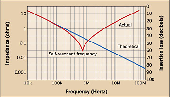

Capacitors and resonant frequency. With a perfect capacitor, you would expect impedance to decrease as frequency increases, as described in the equation Z=1/(2πfC). However, every capacitor has an intrinsic inductance value that, along with its capacitance value, creates a resonant circuit. The self-resonant frequency occurs where the capacitive reactance equals the inductive reactance, as in the equation 1/(2πfC)=2πfL. Fig. 1 shows a graphic representation of this phenomenon.
Further investigation shows that resonant frequency depends on both the lead length (inductance) and the capacitance value. Looking at Fig. 2 on page 22, you can see that different lead lengths (20 mm and 100 mm for a 1µF capacitor) produce different resonance peaks. Fig. 3 on page 24 shows the effect of different capacitor values (0.01µF, 0.1µF, and 1µF) with a 20-mm lead length. The resonant frequency decreases as the capacitance value increases.
The longer the leads, the greater the inductance and lower the self-resonant frequency. Although Fig. 3 represents impedance, you can also use it to represent insertion loss. Therefore, as the frequency increases above the self-resonant point, the capacitor begins to lose its attenuation characteristics. In fact, it starts to function more as an inductor.
