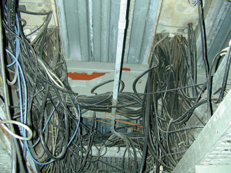

The electrical signal cables extending from the displays, controls, and indicators in the control room penetrated the floor of the control room extending through the second level to the computers and programmable logic controllers (PLCs) on the first level. Part of the raw sewage that was discharged on the control room floor drained along the cables into the cabinets of the PLC that controlled the fuel safety system (Photo 1). The fuel safety system (FSS) is a highly integrated control system, required by the boiler code (NFPA 85C at that time), that monitors and controls the conditions in the boiler and the status of blowers, igniters, and valves, enforcing specific safety protocols on the system, whether the boiler is firing or not. At the time of the water incursion, the boiler wasn't firing, but the water damaged a number of PLC components, causing the PLC to go into a fault condition. Although the FSS had been contaminated with raw sewage, the plant operators didn't close or lock-out/tag-out the main gas valve for the boiler, as their own procedures required.
The electrical maintenance personnel that were enlisted to assist with the system cleanup and repairs received the call at the end of their eight-hour shift. For various reasons, management assigned to the task three technicians with no prior experience in working on this FSS. The technicians' response to the flood was to wipe the affected devices and blow them dry with compressed air, rather than to follow the recommendations of National Electrical Manufacturers Association (NEMA), “Guidelines for Handling Water Damaged Electrical Equipment,” which would have required them to replace the components and/or return them to the manufacturer for condition assessment. The affected FSS devices included relays, circuit breakers, input/output (I/O) interface cards, and I/O controller cards. One of the devices that failed was part of the electrical path called the “hardwire trip” circuit that sent a continuous “close” signal to the main gas valve for the plant. The electrical maintenance technicians apparently reset the hardwire trip circuit in the course of their troubleshooting efforts. Although this didn't cause the gas valve to open at that time, it did terminate the “close” signal, which would have overridden any inadvertent “open” signal.
