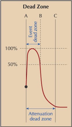

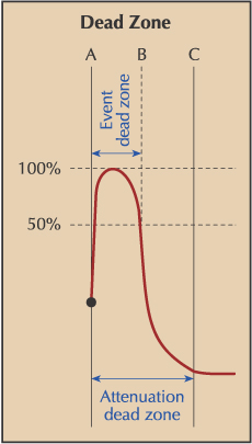

Dead zones.” OTDRs have a “dead zone” (Fig. 1, right) that may extend a hundred meters from the unit in which accurate readings are unavailable. You can overcome this limitation if you use a launch cable, but you must carefully interpret the signal trace (Fig. 2, below).

Dead zone. As mentioned above, the dead zone is the space on a fiber trace following a fresnel reflection, in which the high return level of the reflection covers up the lower level of backscatter. This space is directly related to the pulse width of the laser source; a short pulse yields a relatively small dead zone, and a long pulse yields a relatively large dead zone.
