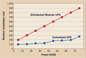

Distributed power may not be the answer. Distributed power installations can be more expensive, on a cost-per-kilowatt basis, than a centralized installation (Fig. 1 on page 20). Although a centralized UPS, oversized to provide for future growth, may be fractionally more expensive to build and install, expansion of a distributed system may be extremely costly in terms of equipment purchase as well as downtime and disruption of power during subsequent installations. In a distributed installation, with dozens and even hundreds of individual UPS systems, end-users may end up paying for what amounts to duplicate or multiple user interfaces as well as packaging, cabling, and mechanical features that may have negligible contribution to reliability.
Because planning ahead is essential for any large installation, you should make accommodations for proper wiring, distribution, and circuit breakers — all of which are extremely expensive to add after the fact. Whether the installation involves one 200kVA UPS or 100 2kVA systems, you must size the electrical service to the area for the total current required. Clearly, it's certainly not practical to increase the overall service to the facility in 2kVA increments. In most cases, neither is adding UPS systems in a piecemeal fashion. Rightsizing centralized power from the beginning usually permits smooth installations with virtually no disruption to nearby equipment.
