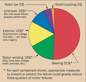

Failure surveys. It's common to use the results of failure surveys to diagnose the cause of a specific motor failure, but it can be a costly mistake. Most failure survey data for electric motors is influenced by the particular industry, the geographic location, and the combination of the motors in use. Therefore, specific numbers may not always be relevant.
Not only that, most failure surveys focus on the component that actually failed while neglecting to address the root cause of that failure. For example, such a survey may tell you that a bearing failed, but that isn't the root cause; it's simply the component that failed. The root could be one of several things, but it's not specified.
The data provided by the Institute of Electrical and Electronics Engineers (IEEE) study shown in Fig. 1 above is helpful because in addition to identifying failed components, it suggests the most likely causes of failure based on which component failed. However, that's still not enough. It's your responsibility to conduct a thorough analysis to find the definitive root cause of that particular component's failure. These percentages in Fig. 1 may vary based on industry or location.
The real challenge lies in reducing the large category of “unknown” failures. It's these “unknown” failures that make analyzing the entire motor system so critical.
