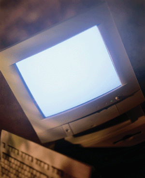

Our firm recently received a call from an electrical contractor who was performing work in a hospital that was having problems with a flickering CRT monitor. What seemed like a fairly simple problem at first, this disturbance wouldn't respond to the most obvious corrective efforts. After arriving on-site, we first inquired how frequently the monitor flickered. If it only flickered occasionally, we could attribute the problem to other office equipment cycling on and off on the circuit, which may have been close to its capacity rating. Such culprits might have included a laser printer, fax machine, or copier that would cycle when copies were made or when the heater cycled on and off. However, the problem proved to be more elusive.
Plan B.
Once we had ruled out the effects of other office equipment on the monitor, the quickest way to identify the problem was with the “black-box” approach. We started by moving the monitor to other parts of the building and powering it from different sources. This proved that the disturbance lay in the monitor's original power source, so we plugged in a different monitor at the offending location. Predictably, the problem resumed. Therefore, we concluded the power quality issue stemmed from this particular area of the building, not the monitor itself.
Next, we took power readings on the branch circuit supplying this area, measuring volts, amps, power factor, and total harmonic distortion for both current and voltage. When all readings fell within acceptable ranges, we suspected an outside source was behind the flicker. We constructed a wire mesh shield around the monitor to determine if radio frequency interference (RFI) was the cause of our problem, but the flicker remained.
At this point, we asked the local electric utility to visit the site. Their investigation revealed that the flickering monitor was located near a wall adjacent to utility-owned transformers, and directly above the main switchgear for the facility. The utility's power quality specialists measured the magnetic flux densities in the room with a Gauss meter. After the room was mapped, the problem stood out immediately.
Any time electric current flows through an appliance or wire, it creates a magnetic field. This field is measured in units of milligauss (mG). The highest magnetic field magnitudes are typically found at a transformer or high-current conductors. Field strength at one side of the room in this location — the side the jittery monitor was on — exceeded 10 mG. Industry research has shown that video display problems from magnetic field interaction can begin at flux densities in the range of 10 mG to 14 mG.
